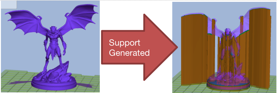

The support generation routine in Tiertime system is first the slicer will generate all possible supports base on the support parameters, then user can make adjustment base on the result of automatic generation.
click
button to open the support editor, the support generation will also take place as soon as the editor is opened.

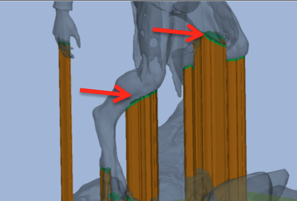

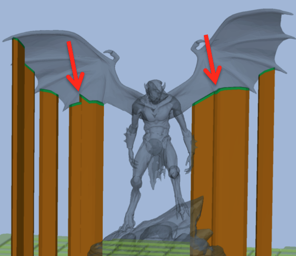

1. Surface support that support a surface
2.支持,支持优势特性。

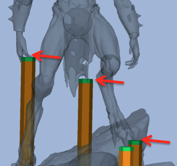

3. Tip support that support tip features.

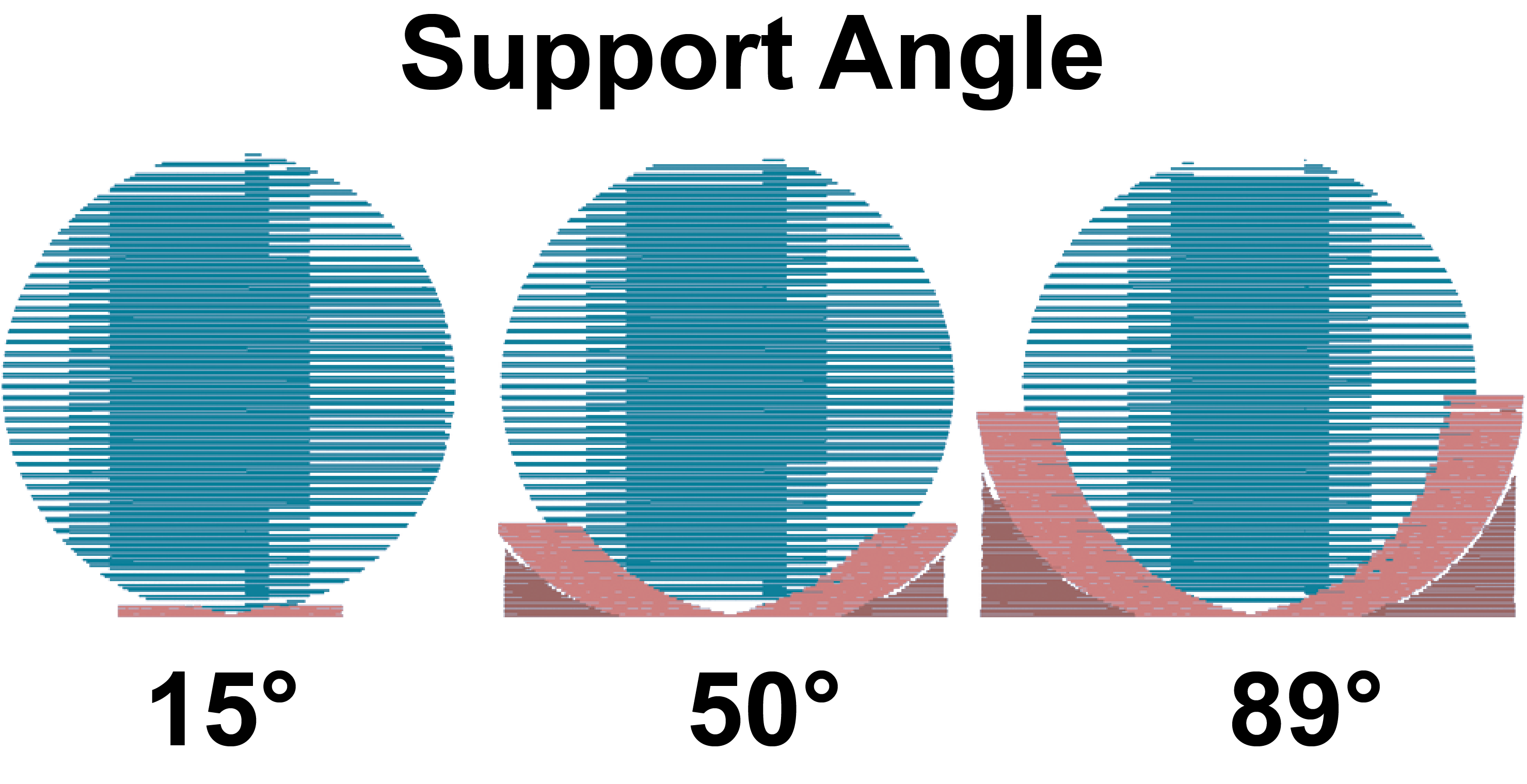

Sup(port) Angle:the tangential angle of the surface that determines if the surface need to be supported.

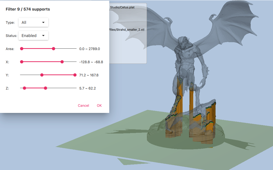

Support Filter
Click the "Filter" button will open the support filter.
The support filter allows user to filter support base on support type, support status (on/off), Area threshold and XYZ coordinate range.
After setting up the filter parameters, click "OK" will go back to the support editor interface but the list will be updated with filtered results. All supports that are not meeting the filter parameters will be omitted in the list.
Support filter is very useful if user want to only consider a specific sub-set of supports.
