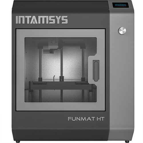

      Yesterday I got my 0.4mm nozzle out of the acetone bottle its been sitting in all week. It had some gunk at the bottom of the nozzle. Whether that was contamination, pigment particles that were too large, or carbon deposits, I managed to get it out by using a syringe and blasting water in and around it. I also had to get a toothbrush in the threaded end to carefully wipe it around to remove some stuff out. Cleaned with water once again. It looked like new in there so ok, back on the printer.
      I’m very happy to say, its been 10hrs of printing with zero issues so far - even with tiertime filament, stock settings at 55c ambient internal temperature. Previously it was jamming on me at those elevated temperatures.
